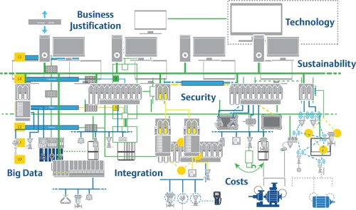

When you look at the IIoT through a cross-functional lens as depicted in Figure 1, the challenge seems formidable.
Apparent Complexity
Figure 1.The IIoT touches a lot of elements, which can make implementation seem daunting.
