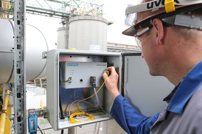

Figure 1. Matthias Hüning of Evonik plugs a glass-fiber coupler connected to the measuring probe into channel one of the transmitter.
Evonik’s Matthias Hüning (Figure 1), a specialist in electrical measurement and control technology in the company’s high-performance polymers business sector, describes the problem in his plant as follows: “We use tube-bundle reactors in our production plant for laurolactam, a starting material for Vestamid L. The challenge is to install a sufficient number of temperature measurement points in a small space within a single tube reactor in order to quickly detect high temperatures and undertake countermeasures. In this way, we can prevent destruction or the accelerated aging of the catalyst due to overheating. This avoids a plant shutdown, which would otherwise be required due to the complicated procedure for replacing a catalyst.”

At Evonik, a glass-fiber coupler connects the sensing fiber in the reactor and the transmission line to the transmitter. This coupler just needs disconnecting when maintenance requires, for example, opening the reactor cover. The measuring probe itself can be easily pulled out when necessary and rolled onto a spindle. The latter also enables it to be easily and safely transported.
The Sitrans TO500 transmitter provides the determined values for analysis in control systems via a Profibus DP interface and makes them available for management of the assets and optimization of the process.
