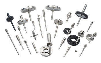

Thermowells
Figure 1. These fittings come in a variety of shapes and sizes for insertion into process piping and vessels.

This method probably is the most common at chemical plants. It uses a sensor to measure the temperature of a liquid or gas — getting the sensor to the desired point in the process is essential but not necessarily easy. The method is intrusive; it requires inserting the sensor into the product stream, typically using a thermowell (Figure 1). When designing a thermowell installation, mechanical issues become the most problematic elements for a variety of reasons.
First, a thermowell is directly exposed to the process and, therefore, is part of the larger process containment strategy. If the process liquid or gas is corrosive or abrasive, the thermowell must tolerate the aggressiveness of the medium; its material of construction must match or exceed the specifications of the piping and other wetted equipment. The thermowell also must withstand the process pressures and temperatures; this requires use of appropriate material cross-sections and mounting techniques to ensure leak-free service, to avoid contamination or an environmental incident.
Second, the thermowell insertion point determines where the actual measurement is made in the process. To get a reading at some specific spot within a pipe or reactor deemed critical, the thermowell must extend to that point. However, that can pose issues. For instance, mechanical or process constraints may complicate obtaining a crucial temperature measurement at the bottom of a reactor. They may necessitate installing the thermowell from a side some feet away and result in a long unsupported structure that can invite problems.
Third, mechanical issues to a large extent determine the response time of the measurement. If the process undergoes fast temperature swings, a thermowell can significantly affect how quickly the sensor sees the difference. Thick thermowell walls reduce the speed at which the sensor discerns a temperature change but may be necessary for structural reasons.
Finally, the thermowell faces stresses caused by fluid movement. Its protrusion into a flowing stream creates alternating pressure cells called vortices. The thermowell experiences vortex-induced vibration. If the frequency of the vortices matches the natural frequency of the thermowell, the resulting side-to-side movement eventually can lead to thermowell fatigue failure. If these vibrations aren’t mitigated and the thermowell isn’t strong enough to withstand them over the long term, it can fracture, causing an opening to the process.
