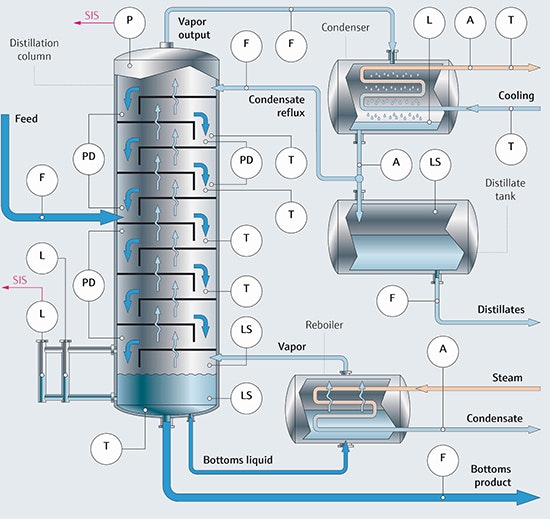

Process requirements dictate the desired pressure profile within a distillation column. Not maintaining the correct pressure at all points can lead to energy waste, inefficient operation that can cause product loss and quality problems and, in some cases, even safety issues. That’s why pressure measurement is one of the most critical parameters for control of distillation processes — and why a column typically has multiple, and sometimes redundant, sensors to measure pressure in various zones (Figure 1).
To maintain the desired pressure profile, the pressure instruments must work safely and reliably. This requires proper selection, calibration and maintenance. So, in this article, we’ll discuss issues found when measuring pressure in distillation columns and review options, selection criteria and safety.
First, let’s set the stage by providing some background about common challenges.
Essential Measurements
Figure 1. A distillation column usually requires a number of pressure sensors (P) at various locations.
