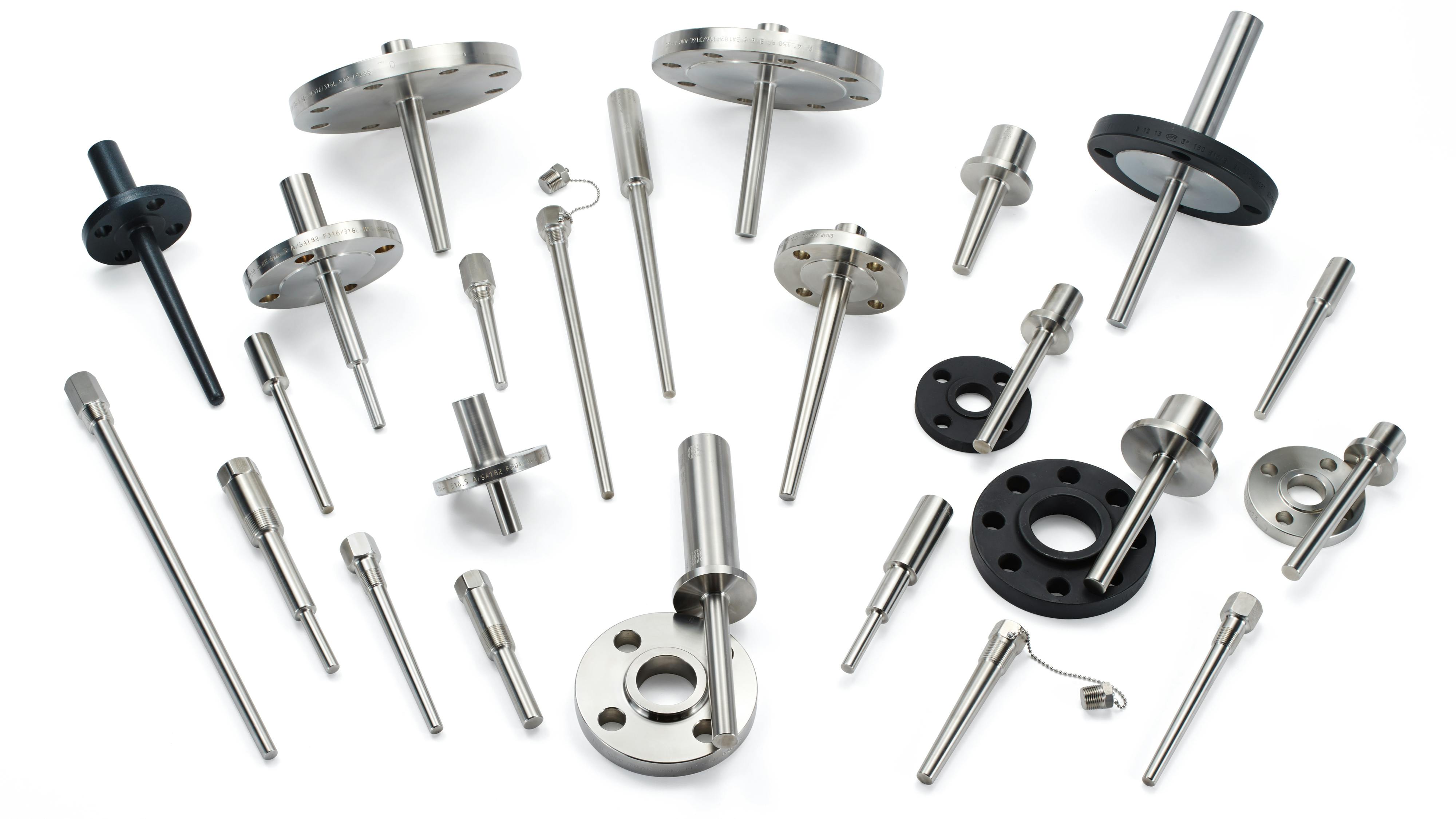

The Thermowell
This device (Figure 1) generally seems the least complex technically. However, more often than not, it actually poses the most problems. These stem from mechanical issues. Therefore, let’s examine how a thermowell works.
Most applications require a thermowell because inserting the temperature sensor directly into the process usually isn’t practical. The sensor normally is encased in a stainless steel sheath, which ideally is relatively thin to ensure fast response. In addition, maintenance technicians may need to remove the sensor from its mount; if it’s a continuous process, they want the ability to do this without losing product containment.
These situations call for permanently mounting the thermowell through the pipe or vessel wall; sometimes it’s threaded into place but usually it’s welded. The thermowell thus becomes part of the product containment but still allows removal of the sensor without interrupting production.
For processes with frequent shutdowns such as batch operations, the uninterrupted containment aspect isn’t as critical. In these situations, the thermowell mount may be attached to the vessel permanently or, alternatively, the thermowell, sensor and transmitter may be a single removable assembly.
There are multiple ways to mount thermowells (Figure 2) depending on the degree of permanence desired and the severity of the process. High temperatures, elevated pressures and product aggressiveness often demand exotic materials and more robust construction, just as with any process equipment.
Many applications don’t subject a thermowell to taxing conditions. For instance, a thermowell extended into a reactor where the chemistry is benign and fluid movement is minimal usually can operate without problems for as long as any other part of the equipment.
The challenge for a thermowell — or, indeed, for any other piece of process equipment for that matter — is when it’s inserted directly into the path of a moving stream. In most situations, the thermowell is perpendicular to the flow, so vortices form on both sides and create high- and low-pressure areas capable of inducing vibration in the thermowell. Sometimes, the vibrations are tolerable but, in certain cases, they can cause serious harm that leads to fatigue failure.
