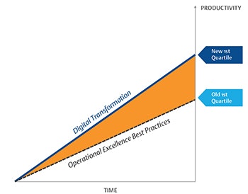

Figure 1. Digital transformation can deliver results that surpass those of operational excellence best practices.
