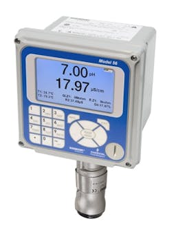

Liquid analyzers have been used for years in industrial applications for pH, conductivity, oxygen, chlorine and other measurements. In recent years, it has become common practice to have line-powered multiparameter analyzers make two or more measurements; using signal cards for each desired measurement type enables a single device to meet the needs of the application. Yet, many users don’t realize that adding or changing signal cards gives these analyzers the flexibility to handle new or evolving applications — solving problems beyond their liquid measurement functions quite cost effectively and possibly reducing costs in other areas of the plant as a result.
Multiparameter Analyzer
Figure 1. Device provides capabilities for control as well as measurement.
