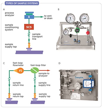

Types Of Sample Systems
Figure 1. Single-line system (a, b) disposes of sample while fast-loop system (c, d) returns sample to process. Source: “Industrial Sampling Systems.”
The final step in designing sample lines for your analytical sampling system is to assess whether enough pressure differential exists between the process tap and the return point to drive the flow you want through the lines. If the differential isn’t sufficient, you may have to apply a different design strategy.
At this stage of the design process, you already will have made numerous decisions related to your system layout and performance. You’ve decided on whether to use a single-line system (Figures 1a and 1b) that disposes of samples via a vent or drain, or a fast-loop system (Figures 1c and 1d) in which the sample returns to process (“Choose the Right Sampling System Transport Line”). You’ve estimated your time delay and made adjustments to meet your acceptable target. You’ve made design decisions related to fluid velocity and flow, and found whether laminar or turbulent flow (Figure 2) occurs in your sample lines (“Consider Flow Regime’s Impact on Sample Analysis”).

Using a larger return line. Most fast loops have supply and return lines about equal in size and length (Figure 1d), making the pressure drop the same in each. This arrangement produces a convenient and simple design when enough pressure is available to drive both lines. However, when you must contend with limited available pressure differential, you can’t afford to waste half of it on the return.
A useful strategy to minimize the pressure absorbed in the return line is to increase its diameter because the velocity of a fluid drops when it enters a wider line. For example, going from a supply line with 10.2-mm internal diameter (½-in. tube) to an equal-length return line with 15.8-mm internal diameter (¾-in. tube) will split the pressure drop such that only about 10% occurs in the return line. The other 90% of ΔP goes to moving the sample to the analyzer. The friction factor of your system may alter this effect slightly. However, in general, when the return line is one line size larger than the supply line and is about equal in length, it’s safe to assume that approximately 85% of ΔP is available to drive the sample to the analyzer.
When dealing with marginal available ΔP, fast loops using larger return lines often are less expensive to install than same-size designs and consume far less flow. For example, you can match the response time of a fast loop with low differential pressure that uses 1-in. tubing by opting instead for ½-in. supply tubing and ¾-in. return tubing. The alternative system would run at only 25% of the original flow rate, making it a better design choice because it’s cheaper to install, uses less sample material and is less likely to interfere with process operations.
