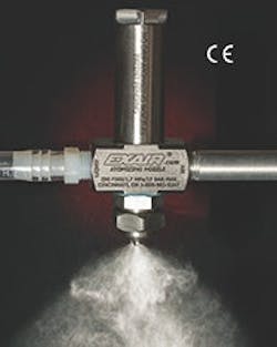

Exair’s No Drip Siphon Fed Atomizing Spray Nozzles require no liquid pressure and can be used with gravity fed liquids or lift liquids from a siphon height of 36 inches (91cm). Siphon fed nozzles can be used on liquids up to 200 centipoise. No Drip Siphon Fed Atomizing Spray Nozzles positively stop liquid flow when compressed air is shut off, according to the company.
No Drip Siphon Fed Atomizing Spray Nozzles are suitable where no post-spray drip is permissible. When the compressed air supply is shut off, the no drip nozzle positively seals off the flow of liquid eliminating the possibility of drips.
No Drip Siphon Fed Atomizing Spray Nozzles are available in a round pattern and a flat fan pattern. They are designed for non-pressurized liquid applications that don't require independent air and liquid control.
Applications include painting, coating, rinsing, cooling, quenching, wetting (moistening), humidification and dust control. The compact atomizing nozzles feature a patent pending no-drip mechanism and have interchangeable liquid and air caps. They are CE compliant and conflict mineral free.
