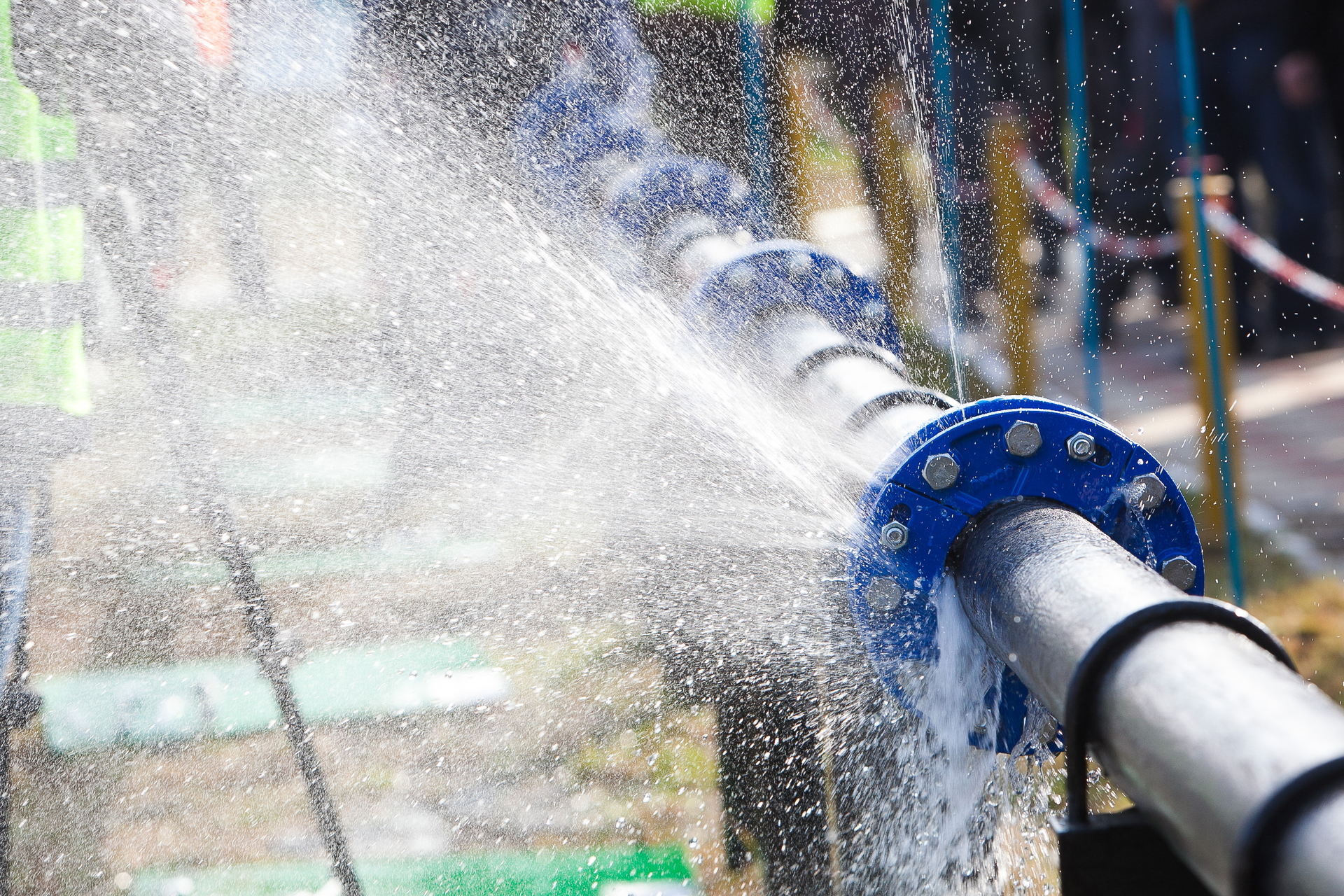

In industrial applications, “water hammer” is a phenomenon that can have significant consequences beyond a loud hammering sound, which may be familiar to people in residential environments. For the chemical processing industry, water hammer can result in a disastrous pipe burst that can lead to costly downtime and potential losses.
Water hammer, also known as fluid hammer, or surge, refers to the pressure response due to a rapid change in fluid velocity in piping systems. When fluid is brought to a sudden halt, the momentum of the fluid is converted to potential energy in the form of pressure. The initial pressure spike due to an instantaneous halt in flow can be predicted by the Joukowsky equation. The Joukowsky equation has been used as a first approximation for more than a century to estimate water hammer pressure surges. Any rapid transient change can produce water hammer including events such as valve closures, pump startups and shutdowns.
Pressure surges following a water hammer event cause both high- and low-pressure waves, each of which may be uniquely problematic. High-pressure waves can exceed pressure ratings, induce large forces and cause excessive vibrations. Low-pressure waves can cause sub-atmospheric pressures, which can collapse equipment and form a vapor cavity if the pressure is reduced to the fluid’s vapor pressure. Subsequent vapor cavity collapse, when the pressure in the pipe rises, can cause secondary pressure surges. The propagation and reflection of the high-pressure wave will also result in a low-pressure wave and vice-versa. While the Joukowsky equation is a common hand calculation when considering surge, system pressures may exceed the initial Joukowsky pressure spike due to reflection and combining of pressure waves, vapor cavity collapse causing secondary pressure spikes, and line pack as pipe friction is recovered.
Although a single water hammer event may not be enough to burst a pipe or destroy a pump, repetitive stress over time due to water hammer can increase maintenance costs as weak spots in the system are worn down. The pressure response from water hammer events can be complex to predict, so computer simulation is recommended to account for the real effects of wave propagation and interaction in a particular system. Understanding the cause and effect of water hammer enables an engineer to mitigate its consequences.
