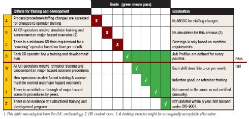

Now, let’s consider how a human factor checklist would be used in practice (Table 1).
Table 1.  In this example training gets a 'D' because no MOOC plan exists and there is no simulator training. (Click to enlarge.)
Suppose an organization that has roaming operators that work inside and outside of a control room. Half of their day involves working in the field and the other half with a distributed control system (DCS). The organization plans to change this. In the new structure operators are to be dedicated exclusively to inside work.
After a cursory review managers recognize that the current DCS workload represents only about 40% of a shift’s workload. The easy solution is to consolidate this job position with similar jobs until under normal operation the operator is doing 100% of a job. The manager must then consider the outside portion of those consolidated jobs and ensure that all the field positions are filled. This isn’t always as easy as consolidating console jobs which are all in the same room. The field can be geographically challenging and units can be miles apart. So added to the field operators workload is travel time.
The checklist may expose some of the assumptions about common management systems but it won’t identify all of the problems. It’s clear from this example that the training is going to be very different and that console operators will need extensive cross-training. Even if the written procedures are accurate, operators working as a close team have their own ways of implementing a procedure, and every shift tends to do it differently. We aren’t saying that this is a good practice only that this is a fact. Teamwork, in this case, is an impediment to cross-training. The danger of this impediment can be countered by preparatory meetings before procedures are carried out. This new organization would benefit from a more formal procedure with assigned jobs against job posts (descriptions).
After shuffling the deck a new organization may find that some tasks aren’t being done or that they are being done incorrectly. So many things in the past may have been communicated by face-to-face communication. Now, in the new structure, radio communication is relied on. Communication standards should be reviewed and the potential loss of the radio system should be thoughtfully considered. A generic checklist won’t work. This should serve as a caution against reliance on avoiding discussion while implementing an MOOC. Fortunately, a better guideline exists.

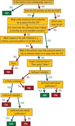

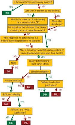

The physical assessment tests the staffing arrangements against six‘’:
i) There should be continuous supervision of the process by skilled operators, i.e., operators should be able to gather information and intervene when required;
ii) Distractions such as answering phones, talking to people in the control room, administration tasks and nuisance alarms should be minimized to reduce the possibility of missing alarms;
iii) Additional information required for diagnosis and recovery should be accessible, correct and intelligible;
iv) Communication links between the control room and field should be reliable. For example, back-up communication hardware that is non-vulnerable to common cause failure should be provided where necessary. Preventive maintenance routines and regular operation of back-up equipment are examples of arrangements to assure reliability;
v) Staff required to assist in diagnosis and recovery should be available with sufficient time to attend when required;
vi) Operating staff should be allowed to concentrate on recovering the plant to a safe state. Therefore distractions should be avoided and necessary but time consuming tasks, such as summoning emergency services or communicating with site security, should be allocated to others. [1]
The assessment is in the form of specific questions, each requiring a yes/no answer (see Figure 1). The questions are arranged in eight trees. The choice of scenarios for assessment is critical and must consider the worst cases both in terms of consequence and of operator workload.
