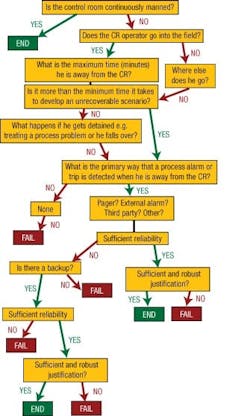

Figure 1. Splitting an operator between field and control room could have consequences.

The physical assessment tests the staffing arrangements against six‘’:
i) There should be continuous supervision of the process by skilled operators, i.e., operators should be able to gather information and intervene when required;
ii) Distractions such as answering phones, talking to people in the control room, administration tasks and nuisance alarms should be minimized to reduce the possibility of missing alarms;
iii) Additional information required for diagnosis and recovery should be accessible, correct and intelligible;
iv) Communication links between the control room and field should be reliable. For example, back-up communication hardware that is non-vulnerable to common cause failure should be provided where necessary. Preventive maintenance routines and regular operation of back-up equipment are examples of arrangements to assure reliability;
v) Staff required to assist in diagnosis and recovery should be available with sufficient time to attend when required;
vi) Operating staff should be allowed to concentrate on recovering the plant to a safe state. Therefore distractions should be avoided and necessary but time consuming tasks, such as summoning emergency services or communicating with site security, should be allocated to others. [1]
The assessment is in the form of specific questions, each requiring a yes/no answer (see Figure 1). The questions are arranged in eight trees. The choice of scenarios for assessment is critical and must consider the worst cases both in terms of consequence and of operator workload.
