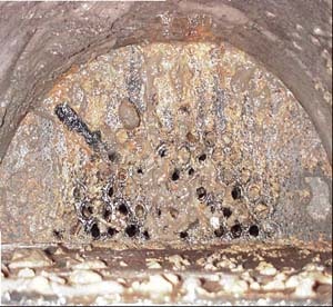

Figure 1 shows an uncoated tubesheet and tubes after one year in cooling water service.
Figure 1. After one year in service, this tubesheet exhibits severe fouling.
