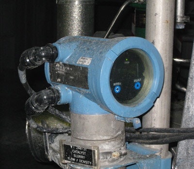

Then, the alert monitor exposed a drive gain issue that indicated sensor tube pluggage on a Type A critical mass flow meter measuring catalyst slurry; at the time production personnel were unaware of any potential blockage issues or inaccurate measurements. If this problem were to have gone unrecognized, the potential financial impact on the process could amount to as much as $25,000 per hour.
By accessing the flow meter's diagnostics, we quickly recognized the problem, which was corrected by backflushing sensor tubes to clear partial blockage and bring all diagnostic indications back into normal range. The process engineers and production personnel became "believers" after this type of alert was repeated several times on various mass flow meters within the process.
