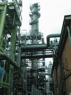

REBUILT COLUMN
Figure 1. After corrosion problems, column was rebuilt using duplex stainless steel but stress corrosion cracking occurred after a few years.
However, under certain conditions — mostly involving chloride-containing fluids and elevated temperatures — even duplex stainless steels are vulnerable to this type of corrosion. This makes thorough failure analysis and corrosion testing imperative. The current condition of the materials used is not only important for safety and availability but also crucial for the profitability and the service life of existing plants.DISTILLATION COLUMN CORROSIONAt a chemical plant, a failure occurred in a distillation column that had been in continuous operation for ten years. The column was made from robust austenitic steel (1.4571, titanium stabilized). Stress corrosion cracking in various areas of the wall caused the failure. The bottom of the column suffered the most severe cracking, but stress corrosion also was found in upper parts of the unit at a height of up to 15 meters. Corrosion was attributed to an acidic oxygen-free aqueous chloride solution with highly oxidizing admixtures that had a temperature of 125°C in the bottom and around 90°C in the upper part of the column.The experts sought an alternative material that is completely immune to stress corrosion cracking. After laboratory analyses, they selected a duplex stainless steel (1.4462) and reconstructed the column in this material (Figure 1). To improve the column’s resistance to stress corrosion cracking even further, its internal surface was treated by applying strong pickling agents to remove a specific amount of material (normally 3–5 µm) from the surface together with all superficial residual stresses.
