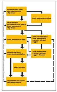

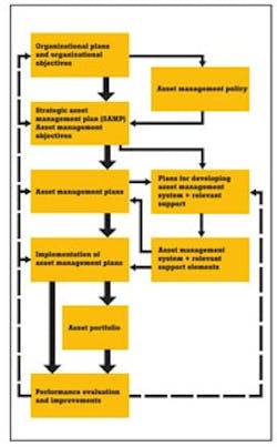

The ISO 55000 Asset Management standard outlines what an organization must have in place to manage its assets in a responsible manner to benefit the corporation as a whole. The standard does this through a networked system of key elements for implementing an effective ongoing strategic asset management plan (SAMP), as shown in Figure 1.
Asset Management System
Figure 1. A number of key elements underpin effective asset management. Source: ISO 55000:2014(E) Annex B, Page 17.
ISO 55000 consists of three standalone documents: ISO 55000, an overview that spells out the principles and terminology used in 55001 and 55002; ISO 55001, the actual management systems requirement document that details the elements against which a company will be audited and certified; and ISO 55002, a guideline for the application of ISO 55001.

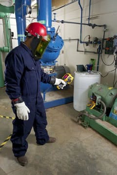

Figure 2. Diagnostic tools now sync with cloud databases, improving the reliability of data capture and communication. Source: Fluke.
Recently, vendors of handheld condition-monitoring tools have made great strides, as exemplified by the Fluke Connect system. Many traditional measurement tools (Figure 2) now are linked to a smartphone-accessed cloud database that easily is set up to record and trend readings and send an alarm to a user when a no-go exception is found or impending. Many of these tools also can be used in conjunction with one another. For example, an infrared camera, vibration monitoring pen and electrical meter all could be employed to check out a problem with a motor-driven pump. Once the tools are in place, a wireless data management app collects and manages all three sets of data on the same asset simultaneously, helping the inspection team get to the root cause more quickly and supporting the ISO 55001 documentation requirement.
User interfaces on the tools have been simplified enough that lower-skilled individuals with minimum training and experience can achieve reliable results. Any member of the maintenance team who shows the appropriate aptitude and diligence can take infrared training, become independently certified as a level-one thermographer, and be placed with confidence in a condition-based check program on power transmission systems, heating and cooling systems, steam traps, insulated systems, etc. This type of approach also is relevant to “Performance Evaluation” (Clause 9) and “Improvement” (Clause 10).
