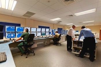

Remote Monitoring
Figure 1. Company now offers three levels of asset monitoring and control to its customers. Source: Air Products.
