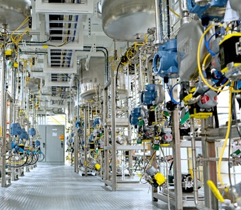

Ample Instrumentation
Figure 1. Because pilot plants usually are well instrumented, inadequate attention to calibration needs can markedly hamper startup. Photo courtesy of EPIC Process Systems.

9. Perform a detailed review of the design for startup problems. This simple step often can identify many potential issues, so you can modify the design to avoid them and thus save significant time and effort later. The list of overlooked startup problems is extensive but some typical examples include:
• How can the instrument be calibrated? Does it demand special training or tools? A pilot plant usually has loads of instrumentation (Figure 1), so, ignoring such issues may severely slow startup.
