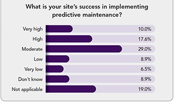

Online polling conducted by CP late last year shed some light on the success of plants in achieving predictive maintenance. While more than a quarter of respondents said their sites had attained high or very high success, a larger number reported only moderate success, and over 15% called success low or very low (Figure 1). Several reasons account for the disparate results, say vendors, who also suggest a number of ways to improve outcomes.

Figure 1. Only about one quarter of respondents to a recent CP online poll said their sites had achieved high or very high success.
