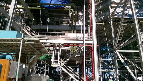

Pre-commissioning starts during the final steps of construction and installation, with the aim of making the unit or plant ready for commissioning and start-up (Figure 1). In other words, the main objective of pre-commissioning is achieving the orderly handover from the construction team to the commissioning team and, subsequently, to the normal operating team. This involves a set of inspections, tests and checks as well as troubleshooting and addressing any issues identified.
