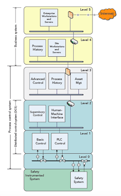

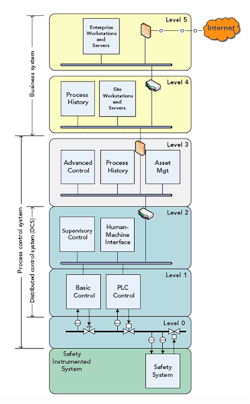

Today’s Typical Hierarchy
Figure 1. Manufacturers generally deploy process control and business system hardware in five levels.
Numerous factors are driving this need: global markets and competition make laggards in innovation unsustainable; changing environmental laws and sensitivities require new tools for compliance; and reimagined capital budgets consider operational flexibility and profitability not only efficiency and safety.
Digital transformation and asset performance maximization place a call on business systems, cloud and computing architectures, and process automation and control systems that operate manufacturing plants. Major global industrial and chemical companies are collaborating with leading process automation vendors and system integrators to accelerate this revolutionary change in automation through the adoption of The Open Group Open Process Automation Standard (O-PAS).
To fully benefit from the immense power of new digital tools such as artificial intelligence, machine learning, cloud computing, data analytics and edge computing, the chemical industry must adopt an open standard like O-PAS to accommodate and implement continuous change. Such a move will enable operating companies to affordably upgrade equipment in-situ, rapidly reconfigure production to respond to sudden market opportunities, and continually apply improved algorithms with deterministic results. Moreover, it will allow working within system constraints such as keeping human/machine interfaces and operational procedures usable by current and new workers, aggressively implementing digital security, and never compromising operational safety. O-PAS, the second version of which has just come out, provides a critical standards framework to address all these factors and many more.
The Current Situation
Since the 1970s, the state-of-the-art for process control and business information systems at process plants has consisted of a multiple-level hierarchy of interconnected computing devices, sometimes called the Purdue Model. This hierarchy (Figure 1) has the process control systems as Levels 1 to 3 and the business systems as Level 4 and 5.
The process control systems, usually described as distributed control systems (DCSs), monitor and control manufacturing processes. A DCS typically consists of operator and engineering stations, controllers , input/output (I/O) modules and application servers. Such control systems generally remain in service for a long time, often for decades, even as the surrounding business network and enterprise systems (Levels 4 and 5 in Figure 1) are upgraded. The closed proprietary nature of Level 1–3 systems provides a significant obstacle to change at those levels.
However, for legacy systems installed in the 1980s and 1990s, obsolescence of components is a real problem. Obtaining hardware and patching the software to keep the systems running are increasingly difficult; loss of institutional memory and programming skills for legacy systems compound the problem. Opting to “rip and replace” the installed system is very expensive and time consuming, affecting both productivity and profitability. Moreover, closed systems don’t allow for ease of access to data that complex algorithms use to generate actionable operational insights that can boost productivity and truly drive a digital-enabled organization. The concept of a layered hierarchy of access seems increasingly at odds with the emerging trend of open access to data and trends in digital enablement.
Security was an afterthought in legacy systems; the majority of security measures focused on physical access controls. As networking and computing technology improved, strong business drivers emerged for interconnecting these networks to allow centralized process control and sharing of information across the enterprise. The convergence of once-isolated control systems with information technology (IT) networks has introduced new security risks, exacerbated by lack of encryption and authentication technologies as well as availability of open-source information regarding industrial control system architectures, operations and vulnerabilities.
In addition to the technical issues, legacy systems pose an inherent business problem by strongly favoring incumbent suppliers. The closed proprietary nature of the interfaces enables those vendors to control access and affords them “vendor lock,” whereby they gain a recurring revenue stream for provision of exclusive services.
