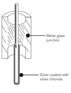

Normal Reference System
Figure 2. This relies on a silver wire coated with silver chlorine.
• “G” or general-purpose glass is used in processes where the nominal pH value varies around pH 7 and the operating temperature is from -20° to 70°C.

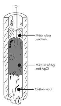

High Temperature Reference System
Figure 3. Such a system uses of a paste containing silver, silver chloride and potassium chloride.

Generally, reference electrodes rely on a silver/silver chloride-potassium chloride (Ag/AgCl-KCl) system. The reference system consists of a silver wire electrolytically coated with silver chloride (Figure 2). This metal-metal salt combination is dipped in a KCl solution.
An alternative construction more suitable for high-temperature applications dips the silver wire into a paste of Ag, AgCl and KCl (Figure 3). A plug of wadding soaked in KCl seals the paste into a tube. This reference assembly similarly is dipped in a KCl solution.
