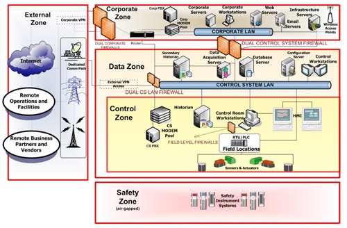

Multiple Firewalls
Figure 1. A company should install an Internet-facing firewall and well as ones between its corporate and control networks. Source: ICS-CERT.

ICS-CERT also offers a series of general defensive measures that can be used to protect against this specific risk and other related issues; for instance, it suggests the use of multiple firewalls (Figure 1). Those practices suit virtually any situation and are well worth reviewing. In addition, more extensive guidelines appear in other publications, which can be found with a few minutes of exploration on the ICS-CERT site.
