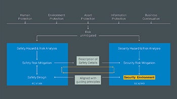

You first must perform an overall hazard and risk analysis. While human protection is the highest priority, safeguarding the environment, assets, information and business continuation also may impact the overall risk to be mitigated.
Safety And Security Risk Management
Figure. 1. Prospective countermeasures must satisfy both safety and security requirements.
As Figure 1 highlights, risk analysis results should go simultaneously to the team responsible for safety and the one handling security. Once set, the safety risk-mitigation concept passes to the security team. This triggers an interactive process to define all related security aspects required to protect the safety system.
The security risk mitigation process results in the definition of a security environment for functional safety agreed upon by both teams. The definitions of the security environment cover features to be implemented inside the components of the functional safety system (SIS) and other measures to comply with the security recommendations (e.g., added firewalls, etc.). Both the safety measures implemented and the related security measures get crosschecked for their compatibility as well as their maintainability throughout the entire safety lifecycle. This ensures the target risk reduction is maintained and that safety and security measures don’t negatively impact one another.
Any conflicts arising must be resolved; if resolution isn’t possible, external risk reduction measures must be defined.
