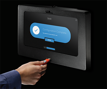

Media Monitoring
Figure 1. Site has installed special system that checks USB devices.

Total now has added Secure Media Exchange (Figure 1). This checks USB devices entering and exiting the facility. It automatically updates threat intelligence and includes human response capabilities to help detect and stop malicious USB actions.
