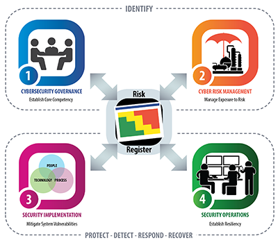

Figure 1. A risk register should form the heart of any program.
A company must align awareness and training in its ICS cybersecurity program. Figure 1 shows the general structure of a typical program. At the heart of such a program is the risk register. It is a living document that feeds into the core elements of a cybersecurity program — governance, risk management, implementation and operations. In this article, we’ll highlight various topics to underscore the awareness and training requirements for these core elements. While by no means a complete list, the subjects covered will draw attention to some key topics within ICS cybersecurity and the prevailing thought process in the industry.
