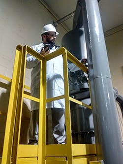

  • A safety assessment: An Aerodyne dust collection specialist will review and inspect the facility’s equipment, installation, controls, and protective devices. This assessment evaluates the facility’s hoods, ductwork, explosion vents, housekeeping, and other related areas. The assessment report will include suggestions for areas of improvement so that the dust collection process will comply with the latest NFPA standards. This safety assessment is recommended as a preliminary step before conducting a Dust Hazard Analysis.
  • A collection assessment: This assessment starts with gathering physical data on system airflow, temperature, static pressure, etc., in addition to a review of the various parts of the system, including the dust collector, fans, dampers, ductwork, hoods, etc. It includes recommendations for changes and operating suggestions to improve system performance and removal efficiency and decrease maintenance, filter replacement frequency, etc.
