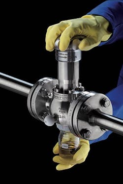

Figure 1. Simple, robust solution helps eliminate exposure and improves industrial hygiene and environmental compliance.
Imagine if the plant alarm goes off while the operator is halfway through sampling; what does he have to do? Well, he or she has to go to the nearest shelter-in-place. And what happens with the sample panel if it's halfway open, halfway purged? It's very complicated. That's one of the problems. The main difference with our systems is they are robust and simple to use. They are very intuitive and there's only one valve to operate. It's an inline valve, and as standard, our valves come with a spring-to-close handwheel, also known as a dead-man's handle, which springs back and shuts the valve should anything happen. So on the one hand you have a system that is complicated, not very robust and inefficient and on the other, you have a simpler, safer and more efficient system. So it’s a big difference.
