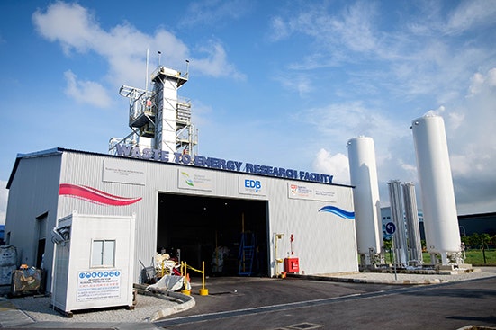

NTU NEA Waste to Energy Research Facility
Figure 1. The waste-to-energy (WTE) research facility will be a test bed and demonstrator for new and emerging WTE technologies. Source: NTU.
