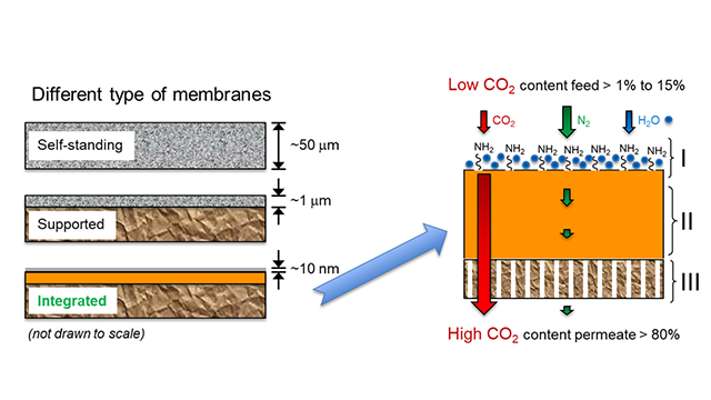

The researchers use so-called “hybrid integrated membrane technology” in which ultraviolet light integrates a nanometer-thick polymer layer onto a base polymer membrane (Figure 2). Then, a CO2-philic grafted-chain surface layer chemically functionalizes this high-permeability thin film.
The hair-like strands that rise from the surface layer contain reactive groups such as amines that bond with CO22 in the presence of water vapor. Pressure in the flue gas or a vacuum on the other side forces gas with CO2 removed across the membrane.
A 20-cm2 membrane was tested at 1.2–5 bar and from 25–55°C, and produced CO2 selectivity up to 150-fold higher than the unmodified membrane.
