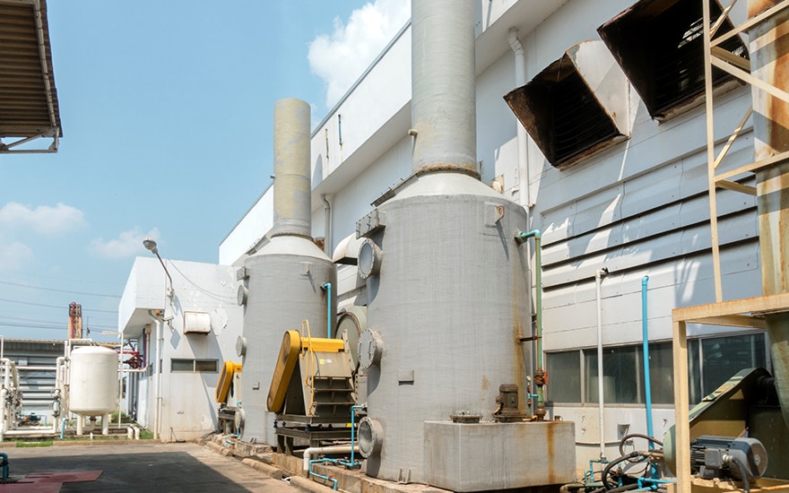

A lot of people don’t like wet scrubbers for emission control because they convert an air problem to a water problem. However, I see this as an advantage, especially when soluble gases are present and you can handle two problems as one. One of the first wet scrubbers I designed was for mist control; mists essentially are particles. Later, when regulations tightened on some of the gases associated with the mist, addition of a pH control system easily allowed for capture of these substances. The solution from the scrubber was crystallized and concentrated for re-use in the process. When installing a control device, it’s wise to consider how changes in regulations or your process can affect the selection of a device.
The Achilles heel of most emissions-control devices is the amount and size of fine particles. Combustion processes create some of the biggest problems because condensation from gas forms many particles. However, growth of these sub-micron nuclei can occur with time, just as it does in a crystallizer. Quenching a process too fast can freeze the particles as very fine ones that are more difficult to capture. In one case, we had a copper calciner that had a very short duct between it and the scrubber. Emissions were high. During redesign of the calciner, we installed a longer duct that improved the scrubber efficiency by allowing the particles to grow. This is another example of an alternative way to control emissions.
