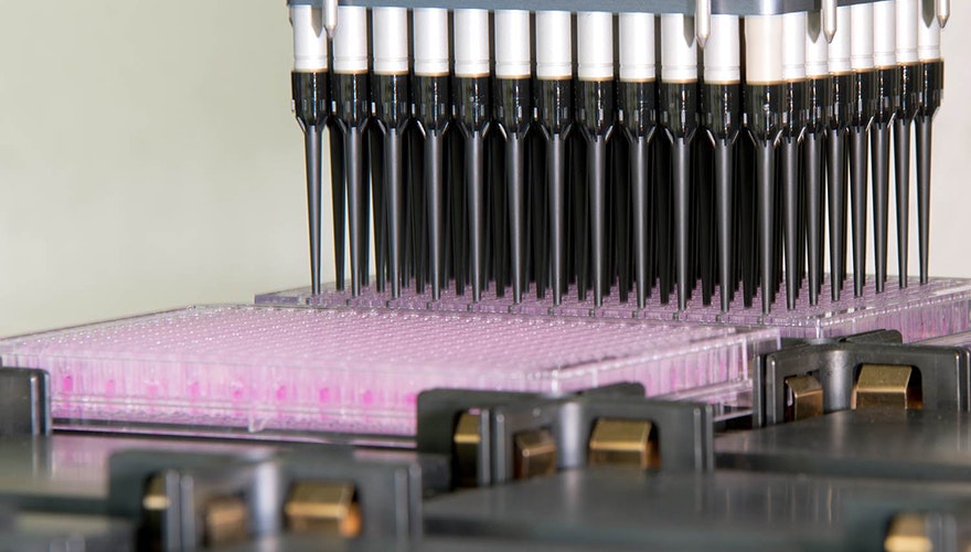

Figure 1. The CITEPro technology platform allows researchers at the UFZ to perform an efficient (bio)analysis and evaluation of environmental chemicals. Source: UFZ/Bodo Tiedemann.

They focus on the benefits of advanced in vitro bioassays which do away with the need for slower and more difficult in vivo bioassays while at the same time being amenable to high-throughput robotics.
“The application of high-throughput in vitro assays for environmental risk assessment of mixtures and complex environmental samples is only emerging but has great potential,” says Escher.
She believes this combination of HR-MS and bioanalytical tools could revolutionize environmental monitoring. This is one of the driving forces behind UFZ’s environment profiler (CITEPro) technology platform that uses high-throughput analytical and bioanalytical procedures to prepare and test samples. However, UFZ describes CITEPro as more than hardware: it is a concept designed to characterize the exposome — in other words, capture the entirety of all environmental influences encountered over an individual’s lifetime. This includes external factors such as chemicals in the air, water or foodstuffs, and internal chemicals produced by an organism in response to various stressors.
