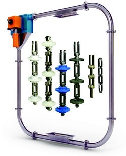

Hapman’s tubular drag chain conveyor smoothly conveys blended materials from the mixer without separation. The engineered distance between flights in the chain assembly provides optimum conveyance while mitigating material flowability, thus preventing the separation of the blended material.
The flexible engineered design allows for infinite layout configurations to efficiently convey a variety of materials beneath floors, around doors and plant obstacles and through walls and ceilings. It also features a heavy-duty chain and flight design.
