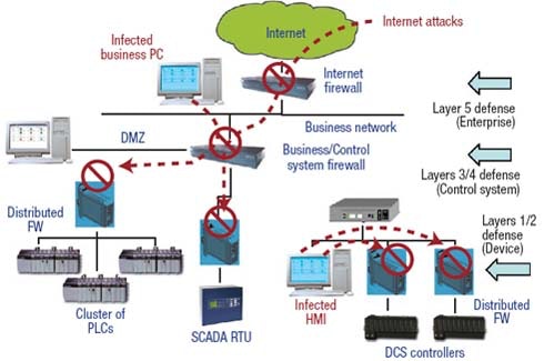

Defense in depth means using multiple layers of protection, so that attackers need to bypass or overcome several firewalls or similar products before they reach the control layer and can cause havoc with plant operation. Defense in depth could be deployed with, as a minimum, a firewall between each layer of the enterprise and a data historian system as a buffer on Level 3 between the control system and the business LAN. Level 3 is often referred to as a “Demilitarized Zone” or “DMZ” and is where all the information transferred between the control and business systems is accessed. The business system can only poll for data from the historian and not write commands directly to the control networks; similarly, any information that the control system requires, such as accounting, laboratory and ERP data, is stored on this system and then forwarded to the appropriate application on the supervisory control system.
Unfortunately, the DMZ, though an excellent tool, isn’t sufficient to provide all the protection required. This is in part because there are many “back doors” to the typical control system — from the dial-up modem or in some cases direct Internet connection for technical support to the wireless networks that for some reason do not recognize site boundary limits. (See sidebar.) Therefore, the defense in depth must continue through to the field layer and the products to go in that environment must also be able to operate in what regularly is a Zone 2 (Division 2) classified area.
Of course, the solution to the problem must not be more difficult than the problem itself. What’s required is a simple modular solution that’s easy to install and configure using techniques with which control engineers are familiar.
A number of manufacturers have released industrially hardened firewalls that require the system administrator to understand System Network Management Protocol (SNMP) and other associated command sets (remember DOS text string commands?) to properly configure each network node. This form of product is manually intensive to maintain, so the firewall manufacturers are now making “front ends” to assist in the configuration. One vendor is designing a new concept from the ground up to be both electrician and control-engineer friendly to the extent that, if desired, the system for the entire company can be remotely managed from a central location.
Figure 2. Besides firewalls between each level, such arrangements usually include a demilitarized zone.
