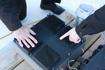

Figure 1. This close-up view shows the thermal resonator (black box) with its radiative cooling fins across the top. The device is filled with a phase-change material that allows it to capture energy from changing temperatures. Source: Melanie Gonick, MIT.
