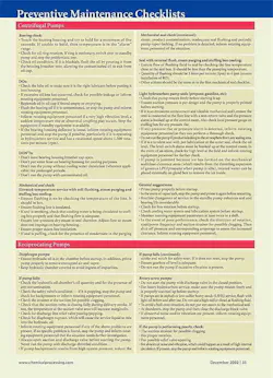

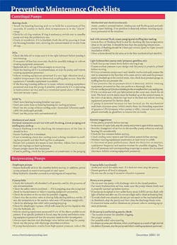

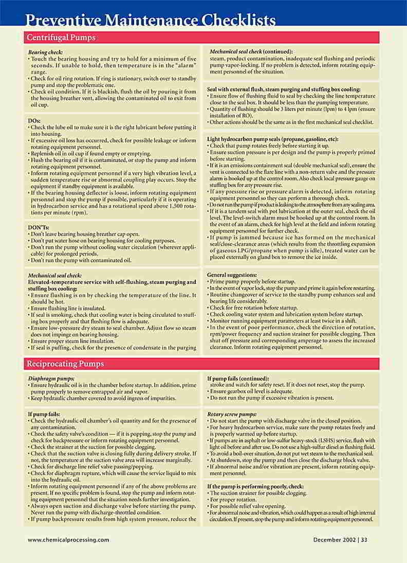

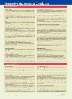

Operation and maintenance
At the Mumbai Refinery, checklists were prepared and circulated to the operators identifying potential failure modes and immediate remedial actions to avoid failure. The checklists provide details for the operation crews about the parameters to be checked and the procedures to check them, as well as any required responses to such situations to avoid failures.
The refinery's preventive maintenance checklists for different types of pumps and their associated seals are provided on page 33.

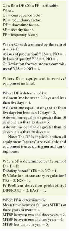

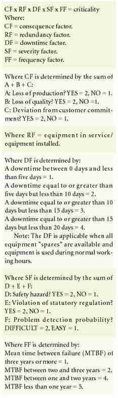

An equipment "criticality classification" was performed at the Mumbai Refinery on the basis of a "failure effect analysis," which considered failure consequence, severity, redundancy, frequency and detection probability. A detailed preventive maintenance schedule then was prepared and executed, calling for:
Preventive maintenance every three months for critical equipment.
Preventive maintenance every six months for semicritical equipment.
Preventive maintenance on an "as-needed" basis for noncritical equipment, based on feedback from daily parameter monitoring.
Preventive maintenance is carried out in compliance with each checklist, and observations are recorded for analysis.
The criticality of the equipment is determined through the following equation:
The equipment is critical if it receives a total score of 80 or more; semicritical if it receives a score of 60 or more; and noncritical if it gets a score below 60.
