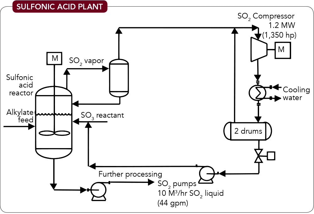

Sulfonic Acid Plant
Figure 1. Traditional design includes a compressor and knockout drum.

Sulfonic acid plant design. Reacting sulfur trioxide (SO3) dissolved in sulfur dioxide (SO2) with an alkylate feed produces sulfonic acid. This is an exothermic reaction that boils off SO2 as its primary means of heat removal. The SO2 performs the role of mutual solvent to allow intimate contacting between alkylate and SO3, which otherwise would only react at their mutual surface. All of the materials are flammable. The SO2 and SO3 are both inhalation toxics.
Aluminum Chloride Silo With Scrubber
Figure 3. Plugging of line could lead to water getting into the silo — causing an exothermic reaction that creates HCl.
The heat of reaction boils the SO2 and SO3 from the reactor. In the traditional plant design (Figure 1), two drums collect the boiled-off vapor and allow the return of SO3 and any knocked-out liquid to the reactor. A compressor and cooling water exchanger provide cooled, liquefied SO2 for recycling to the reactor.
Following inherently safer design principles, the process was modified to eliminate the compressor and collector drums and replace the standard pumps with seal-less ones (Figure 2). This very significantly reduced the inventory of SO2 required to operate the process and removed two pieces of rotating equipment, each of which had the potential to leak toxic material to the air. In addition, because a Freon refrigerant is used, the bulk of the SO2 now is at a temperature not far from its boiling point, which minimizes vaporization in the event of a leak. However, these process safety improvements were achieved by using an ozone reactive material rather than cooling water.
The minimization and moderation strategies enhanced process safety — but opportunities exist to make the process even more inherently safe:
• Use the cooling exchanger as knockout pot and provide for gravity drain of cooled SO2 back to the reactor, eliminating the pump. (This requires relocation of the SO3 injection point.)
• Find a safer solvent than SO2.
