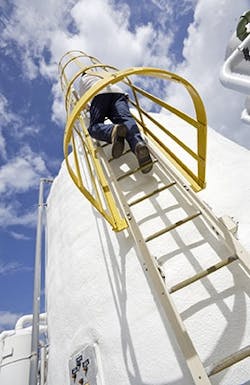

Proof testing traditionally occurs on location. However, the digital technology available in modern level-measurement devices enables performing partial proof testing remotely; the devices remain installed while simulated overfill conditions activate the detector and generate an alarm signal. Use of simulation makes moving fluid into and out of the tank to conduct the test unnecessary and avoids the risk of spills. It also eliminates the need for workers to climb tanks (Figure 1) or be exposed to tank contents, thereby increasing their safety and freeing them up to concentrate on other value-added tasks. The ability to perform partial proof testing remotely has become a key selection criterion when implementing level measurement technology as part of an SIS.

Removing Risks To Personnel
Figure 1. Remotely performing partial proof testing eliminates the need for staff to climb tanks.
