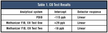

The CO tests
The PDID data were evaluated. The regression analysis showed the data had a 0.9997 correlation coefficient and a non-zero intercept. Because the higher concentration point has a tendency to skew the data, the data were re-evaluated with only the lower part of the curve. However, the data on the lower part of the curve were not as precise as those on the higher part of the curve. The correlation coefficient was only 0.9985 with a zero intercept of -115 ppb.
Evaluating CO data
To test their hypothesis that the ethylene used to make the mixture contained 115 ppb of CO, the researchers increased the concentration of the samples by 115 ppb and re-plotted the data. The curve showed the correlation coefficient did not change, and the zero intercept was 0.06 ppb.
Test One with the methanizer FID system showed a curve with a correlation coefficient similar to the PDID, but the intercept was +29 ppb. This inferred that the system had no response at 29 ppb.
In Test Two with the FID, the correlation coefficient was a little better (0.9996) than both Test One and the PDID, but the intercept was -18 ppb.
That the PDID shows a negative intercept infers the existence of a 115-ppb CO background in the ethylene used to make the test mixtures. In the case of the methanizer FID Test One, the results indicate the signal was suppressed by some 29 ppb. This typically is seen in cases in which the support gases have some level equal to or greater than the sample. In the methanizer FID Test Two, the levels of both CO and CO2 in both He and H2 were reduced to sub-ppb levels. In this case, the system shows the CO background in the ethylene was 18 ppb.
The PDID provided relatively good results all the way down to the 50-ppb level. The methanizer FID still provided more precise measurements over a wider range of concentration ," except for one excursion at 125 ppb. This detector still provided precise information.
Table 1 shows the CO test results.
