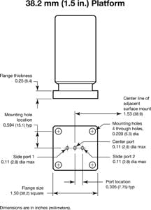

Figure 1. Standards for dimensions enable easily switching single devices without need to modify others. Derived with permission from ISA, www.isa.org.

The NeSSI specification defines two interface “rails” that allow for easy system integration. A fluid rail enables modularity by providing a standard interface to connect flow paths between devices. A bus rail enables the smart transducer and field mounting capabilities by providing IS power and digital communications between the smart sampling system components, the analyzer and the process control system.
In August 2002, a 1½-in. square NeSSI component footprint for the fluid rail was adopted in the ANSI/ISA 76.00.02 standard, which defines properties and physical dimensions for surface-mount fluid distribution components (Figure 1). This fixed footprint enables changing a single element without having to modify the entire system, streamlining design and maintenance.
Adoption of ANSI/ISA 76.00.02 led to the emergence of what are referred to as NeSSI Generation I miniature modular sample systems. Their modular platform components consist of a surface-mount layer made up of devices such as valves, filters and adapters; a substrate layer that provides the flow path between the surface-mount components; and a manifold layer that provides the flow path between two or more parallel substrates (Figure 2).
