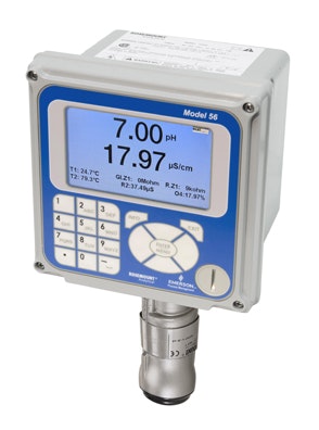

Multiparameter Analyzer
Figure 1. Device provides capabilities for control as well as measurement.
