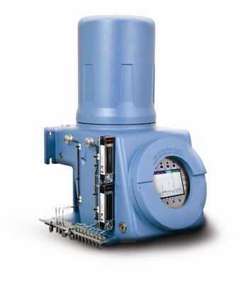

Processors have relied on gas chromatographs (GCs) since the 1950s to provide real-time compositional data to control systems. Today, tens of thousands of GCs serve in a diverse range of plants — making the GC the analytical workhorse for online compositional measurements. The performance of these devices critically impacts the quality of the final product, the efficiency of plant operations and, ultimately, the bottom line.
Process Gas Chromatograph
Figure 1. Units such as this provide compositional data crucial to maintaining product quality and efficient operations.
The GC’s important role means that its downtime should be kept to a minimum and planned ahead of time, rather than taking place only when a failure has occurred. While maintenance may seem like an issue for technicians, in fact, it becomes a management problem when it so directly impacts profitability. Therefore, every plant manager should understand GC maintenance and troubleshooting practices and use them to establish a meaningful maintenance program and provide effective training. Ideally, the maintenance program should identify analysis problems before they cause measurement errors — allowing maintenance to be performed on a predictive rather than an ad-hoc or breakdown basis.

The Analyzer
Routine maintenance on the GC analyzer (Figure 1) primarily involves performing diagnostics and making small changes to timed events to allow tracking the gradual increase in the retention time due to contamination and wear in the analysis valves. When the diagnostics indicate a large shift in retention times from the last overhaul or a dramatic increase in valve noise, then an overhaul of the analysis valves can be planned for a convenient time.
