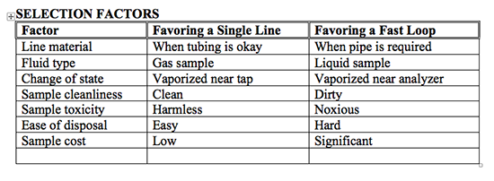

Selection Factors
Source: “Industrial Sampling Systems”
Table 1. Sometimes factors in a specific system will conflict as to the choice but these general guidelines are useful.
Let’s walk through some selection criteria — including sample disposal needs, pressure drop and time delay — that will help you choose the right sample transport line for your application.
