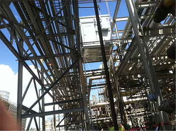

Analyzer reliability and measurement precision often depend on stable climate conditions. In addition, not all analyzers are suited for installation in hazardous locations. A shelter (Figure 1) addresses these issues by offering a protected and climate-controlled environment. Warm climates require air conditioning systems, which may also provide shelter ventilation and purging. Cold climates need a forced-air heating system along with insulation. The bottles supplying gas to the analyzers may be mounted inside the shelter or in heated external cabinets. Larger installations sometimes use a split shelter, with one side for analyzers and the other for the sample gas conditioning system.
Analyzer Shelter
Figure 1. Analyzers usually must reside close to the monitored operation — and this dictates the shelter site.
