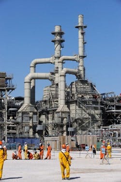

RECORD RENTAL
Figure 1.The Pearl GTL plant in Qatar sets new marks for air-related equipment rental. Source: Shell.
Jointly developed by Shell and Qatar Petroleum, the Pearl GTL plant (Figure 1) is the largest of its kind in the world and takes gas from two unmanned platforms 60 km offshore. It's targeted to produce 1.6 billion ft3/d of gas. Post processing, this will generate 120,000 bbl/d of condensate and natural gas liquids, plus 140,000 bbl/d of products such as chemical feedstocks and lubricants.
The plant also is breaking records when it comes to the demands it made on Atlas Copco Rental, Abu Dhabi.
"Atlas Copco Services Middle East has been mainly involved in the provision of equipment used in the massive pre-commissioning program of the Pearl facility," says Akram Tamari, regional rental manager. "As an example, our oil-free compressors and desiccant air dryers were employed in activities that included air blowing for cleaning, generating instrument air and the pneumatic testing of the fuel gas processing and air separation units. In total, our compressors generated more than 300 million m³ of dry 100%-oil-free air for the project, making it one of the biggest compressor rental projects ever."
"You can imagine that during projects of this size they need compressed air on multiple locations... If they need more flow than expected, the compressors are just a phone call away. That's one of the advantages versus owning equipment," notes Kris Herremans, business development manager, Atlas Copco Rental, Rumst, Belgium.
Regardless of whether a plant requires compressed air for commissioning, a turnaround or to maintain production, reliability is crucial, he adds. "The last thing they want is a breakdown of a rental compressor. That's part of our daily challenges — offering state-of-the-art equipment on a 24/7 basis."

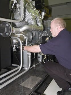

HIGH-PRESSURE COMPRESSOR
Figure 2. Unit boasts less piston and bearing wear, which helps cut maintenance costs.

HIGH-PRESSURE SOLUTIONS
Gardner Denver notes that chemical and pharmaceutical operations increasingly are installing its Reavell high-pressure compressors and boosters (Figure 2). Typical uses include air and other industrial gas compression, gas recovery systems, inert gas blanketing and cryogenic cooling systems.
"A large part of our business is supplying high-pressure compressors and boosters (up to 6,000 psi/350 hp). The key issue here is sizing: the solution must be suitable for the application," explains Paul Green, sales manager, high pressure products Americas.
"The key is to optimize the available gas pressure and size and to configure the machine to ensure its operating parameters are the most efficient, which ensures not only reliability but keeps operating costs to a minimum," he adds.
A focus on initial capital cost can undermine achieving efficiency and optimization, Green warns. "Many markets are still very conservative and there can be issues with getting customers to accept using higher-speed compressors/boosters despite their advantages, such as less bearing and piston wear, higher reliability and lower maintenance costs."
"Customers do look very closely at the purse strings. But a lot of this depends on where the money is coming from and which people within the company you are actually speaking with. It also depends on how critical the application is. For example, we have been asked to repair broken machines that under normal circumstances might be switched out for new models, but the money was there in the service budget so they were repaired rather than replaced."
In another example, the company replaced a 300-hp compressor that was running at 100% all the time with two 150-hp compressors in a lead-lag configuration. The second machine comes on-line only to meet certain pressure demands; the company involved is saving 30–40% on compressed air energy costs as a result.
"Maintainability is a key factor in looking at 'through life costs' of any piece of equipment and is a key feature of all Reavell products," notes Green. For example, the 100-hp (75-kW) 5,000-psig 100-scfm 5437 model can be totally stripped and rebuilt in a day and a half, he notes; a valve change takes just five minutes and a three- or four-stage piston ring can be replaced in just 15 minutes, he adds.
The high-pressure Reavell products all are oil lubricated but Green believes this isn't the drawback users presumed in the past. "Not all chemical applications necessarily require 100%-oil-free air and, with high-pressure Reavell compressors, they have an oil carry-over of less than 2–3 ppm, which is easily removed with final filters. This is down from 20 ppm only a few years ago and getting even better as a result of new ring materials that don't require the same level of lubrication. So there are definitely cases now where people automatically assume they need oil-free, but in reality the required air purity can be achieved through suitable filtration. And this is an argument that we are winning now," he says.
