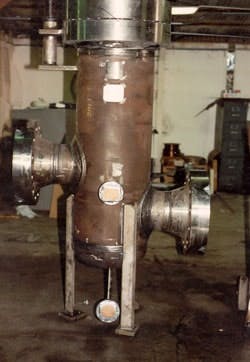

Filter Housings Accept Elements From Any Manufacturer
Flex-Flo Filter Housings are designed to accept filter elements from any manufacturer with any flow regime, inside out or outside in flow.
Being neither flow nor filter element specific, Flex-Flo Filter Housings can always be field adapted to accommodate process changes requiring filter elements with changed flow characteristic or hardware adapters. The housings also can be adapted to provide both pre-filtration and final filtration within a single housing.
The housings, which range in size from 4 inches in diameter to 36 inches in diameter, are fabricated to A.S.M.E. Code Sec. VIII, Div. I requirements in high alloy materials.  Standard housings are designed to ANSI CI 150 and CI 300 Pressure and Temperature Standards.
