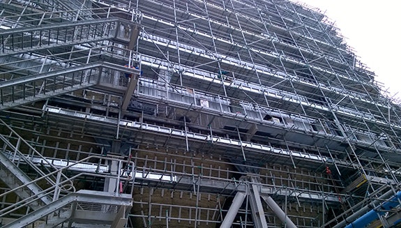

Multilevel Versus Horizontal Layout
To save space and cost, some designs adopt a compact multilevel layout, locating equipment at different elevations but close together and with minimum lengths of piping. Often referred to as a structure-mounted vertical arrangement, this puts the equipment in a rectangular multilevel steel or concrete structure (Figure 1). The structure can be several bays long and either open-sided or fully enclosed (depending upon, e.g., operating company preference, climate conditions, etc.). Stairs or elevators provide access. Piping, cabling, utilities, etc., often enter and exit the structure at one level and gain access to each floor by chases (or similar). It often is difficult, expensive and challenging to provide desired clearances and access. Equipment maintenance usually requires use of hitch points, trolley beams or traveling cranes. Ideally, each item should have an adequate open area around it as well as a clear drop zone at grade for equipment removal. Theoretically, designing and building such a multilevel facility with desired access, clearances and safety is possible. However, doing so is very expensive and challenging. In practice, to save some money, contractors may not strictly adhere to some requirements.
In contrast and still preferable for many applications is the traditional concept of using a horizontal wide layout with ample clearances and excellent access. This usually involves locating a horizontal inline unit within a rectangular area, with equipment and machines arranged adjacent to a central pipe-rack network. Such horizontal layouts obviously incur higher costs for land and connecting piping. However, they far better address and manage issues of access, maintenance, safety and operation.
The land available always has been a major consideration. When space is scarce, such as in a renovation, or when special requirements demand an enclosed building, then the only option is multilevel compact installation. However, I’ve observed several cases where ample land was available but the designer still opted for a congested multilevel facility that used under 60% of the available land and provided less-than-desired access and clearances. Why? Because such a multilevel compact installation was cheaper to design and procure. However, over the long term, such an installation is expensive to operate and maintain, and poses more difficulties and risks.
This points up a crucial lesson. If sufficient land is available, deciding upon an optimum layout requires considering all factors including operation, maintenance, access, etc. Many modern plants and facilities use a combination of both multilevel and horizontal concepts as appropriate.
