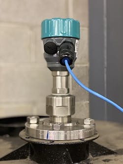

Figure 1. Guided-wave-radar device features power-over-Ethernet communications.
• Centurion guided-wave-radar level transmitter from Hawk Measurement, Medina, Ohio;

Level Transmitter Features PoE Communications
Power-over-Ethernet (PoE) communication offers a number of advantages, including secure and reliable in-plant and off-site monitoring as well the capability for remote sensor set-up, diagnostics and troubleshooting. The Centurion Guided Radar (CGR) level transmitter (Figure 1) from Hawk Measurement is the first and only guided-wave-radar (GWR) unit with PoE communication. It enables monitoring of tank levels from smart phones, tablets and computers.
Commercialized in the United States in January 2021, the CGR level transmitter can measure the level and interface of liquids, sludges, powders and granules up to 124 ft. Its GWR technology provides a response time of <1 sec and an accuracy of ±3 mm; pressure or vacuum, temperature, viscosity, foam, dust, coating of the probe, or changes in dielectric constant don’t affect it. The device can send tank alarms and alerts via email and directly to smart phones.
If troubleshooting is required, service technicians need not enter a facility. Instead, the CGR PoE instrument can send information about its health for off-site diagnostics and, if necessary, reconfiguration.
The device can connect to an online portal, the HawkEye365, to enable monitoring of multiple tanks worldwide in real time. The online portal provides access to critical data, including volume, material height, historical trending, alarms and alerts, sensor set-up and diagnostics. Control-room and operations-level screens can be tailored to operating company specifications; they share a common graphical user interface and can have permissions set for different tiers of employees.
The CGR level transmitter features dual interface capabilities and built-in digital displays. It can auto-calibrate to any dielectric ≥1.5. The device is rated for hazardous gas and dust services by IECEx, FM, CSA and ATEX.
