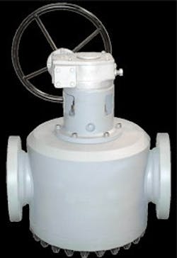

Strahman's Trunnion Mounted, Metal Seated Ball Valves have been designed for severe service applications such as those found in oil and gas, petrochemical, refining, polymer, steam, catalyst, DCU (delayed coking unit) and coal gasification industries. Ranging from PN 10 to PN 630-4500 lb., the special coatings (hardened trim) on the ball and metal seats make them ideal for use in high temperature, high pressure and abrasive environments.
The valves come in one-piece and two-piece designs for ease of use and maintenance. The one-piece design includes bottom entry for simplifying maintenance. This is done by dropping the valve internals without having to first remove the valve from the line. Other features of the metal seated ball valve include:
