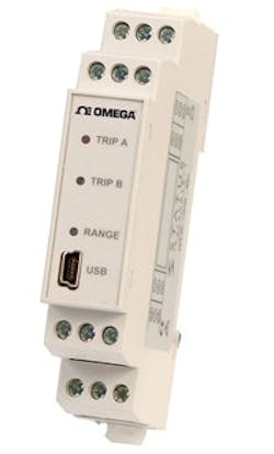

Omega introduces the TXDIN1600 Series temperature transmitter
Omega's TXDIN1600 Series is a new generation DIN rail mounted temperature transmitter. It has been designed to accept most common process and temperature sensor inputs and provide the user with a standard two-wire 4 to 20 mA output signal. Isolation is provided between input and output, and all temperature ranges are linear to temperature.
Designed for ease of use, the USB interface is fitted for quick and easy configuration. Just connect a standard USB cable between the TXDIN1600 and your PC. The TXDIN1600 does not need to be wired to a power supply during the configuration process; it is powered via the USB interface from your PC.
The TXDIN1600 is also provided with user push button trim, allowing trim adjustments at both 4 mA and 20 mA. The user trim function can be locked during configuration if not required. The range led indicates out of range input during normal operation. During user trim, it is used to indicate the stage of trim.
